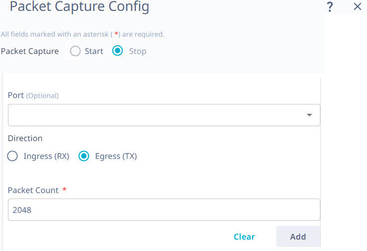

  5. From the Packet Capture actions, select Stop.
    Packet capture config window
  6. Select Delete ( Delete icon ) for the packet capture you wish to stop.
    The packet is removed from the list.
